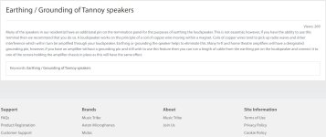

I was reading that Fyne manual and its notes "The purpose of this is to ground any radio frequency interference that may get back to the amplifier". So if your amp is already grounding and like I noted above, why would you ground it again ?
Unless it's a European suggestion
From the Tannoy support website

If you feel that you must ground the speaker, then the last sentence it the Tannoy instructions is the key.
Connect it to the amp's chassis.
While you are at it. Twisted pair (and twisted Quad) speaker cables are better at resisting interference pick-up.
Also run the ground wire in close proximity to the speaker cable.

On second thought about the Tannoy info. It doesn't matter in the least if a driver frame picks up interference. It's not connected to anything.
