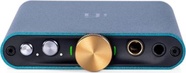

The headphone amp delivers 660mW of power from the balanced output (520mW from the single-ended output) into a 32-ohm load – impressive when compared to the hip-dac’s peers, ensuring compatibility with a wide range of headphone and earphone types. With a rating of 200mW from the balanced output into a 300-ohm load, it drives most power-hungry headphones with ease.
The amp stage features switchable gain, which iFi terms PowerMatch. This matches the level of drive to the load presented by the headphones, by adjusting input sensitivity and thereby signal strength. With high-sensitivity headphone types such as in-ear monitors, leave PowerMatch at its lower setting for ultra-low-noise performance. But if your headphones require more drive – most on/over-ear types, for example – press the PowerMatch button on the front panel to increase gain.
XBass is another user-selectable feature – a sophisticated form of ‘bass boost’ that enhances low frequencies without muddying the midrange, particularly useful with earphones and open-back headphones that may lack deep bass. It operates entirely in the analogue domain rather than messing with the digital signal via DSP and may be switched in or out of the signal path.

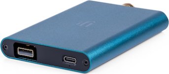

There are two USB ports – Type A for audio data and USB-C for charging. Unusually, the Type A input features a ‘male’ connector, rather than a typical ‘female’ port. This arrangement provides greater mechanical integrity than the USB/Micro USB ports commonly found on DAC/headphone amps from other manufacturers. It also offers an advantage to iPhone and iPad users, because it accepts Apple’s Lightning to USB Camera Adaptor directly without requiring an additional female-to-male USB adaptor. (The Camera Adapter is required to connect Apple iOS devices to third-party USB devices.)

With its petrol blue, 102x70x14mm, extruded aluminium enclosure, the hip-dac has a high-quality look and feel with a colour that is bang on trend – the Pantone Colour of the Year 2020 is also blue. Just the tonic for any headphone fan, the hip-dac is available from February at an RRP of £149 (€159, $149) and will be showcased at CanJam NYC 2020.

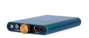

The hip-dac weighs only 125 grams and measures (L x W x H) 102 x 70 x 14 mm, which makes it a sleek, easy to carry, ultra-portable solution, perfect for consumers after a pocket DAC/amp loaded with cutting-edge technology and features way beyond its price point.

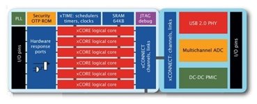

Running alongside the Burr-Brown ‘True Native’ chipset is the 8-Core XMOS based on our own code, which updates it with our own Star Clocking, just as it was done in the micro iDSD.
The hip-dac implements Version 4 AMR XMOS platform and uses the latest generation 8-Core 500MIPS XMOS1 transputer derived main processor. These processors are quite unique in their architecture and based on a technology once considered to revolutionize computing, the INMOS Transputer.
From Inmos to XMOS
The transputer (Trans – Com – Puter) was a pioneering microprocessor architecture of the 1980’s, intended for parallel (multi-core) computing. It was designed among others by David May and produced by Inmos, a semiconductor company based in Bristol, United Kingdom.
For some time in the late 1980’s many considered the transputer to be the next great design for the future of computing. While INMOS themselves ultimately faded from the scene, their pioneering parallel computing platform is echoed in every modern PC running Dual or Quad Core CPUs and in any multi-core CPUs found in i.e. smartphones and tablets. XMOS “Transputer” Chips have since found many applications where their unique architecture outperforms both traditional CPUs and FPGA systems, not the least in USB Audio.
What all this means for hip-dac? Its XMOS unlocked 384kHz/32Bit PCM and 11.2MHz single bit DSD sample rates.
