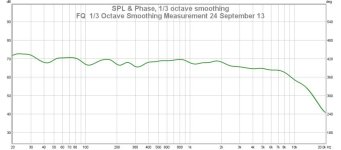

My setup uses Magenpan 3.6s, Kinergetics 800 subwoofer towers, a 3-way active Pass Labs XO and an upgraded internal passive tweeter/midrange XO.
I like Barry's recommendation (!). I set my subs/mains at ~ 80 Hz with steeper 24dB/octave crossovers after I got my seat and speakers positioned.
I use DSP on the subs only. Even though they're rolling off above the cutoff Fq, there is enough useable response from them to equalize up to 200Hz to get a flat overall frequency response. Minimal digital opacity v. DSP full range. Can't do this if you set the XO at a low frequency. There is some delay on the subs. I would do it all a little differently now, but I got tired of messing with it.
If you can't measure what you're hearing at the listening position, integrating subs is a PITA. The high frequency rolloff is that way on purpose and it needs some more work. Overall, it sounds good. YMMV.
Barry (the other one...).
