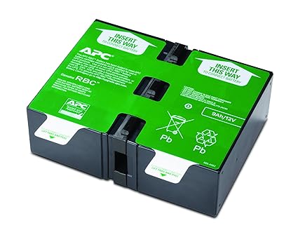

You may also want to check with your vendor on the battery pack supplied.
Check if the APC SMC 1000 can use a 9AH battery instead of the 7AH battery they usually come with.
The 9AH has a better discharge characteristic apart from the longer battery backup.
Nikhil.......I will check into the higher capacity battery. I appreciate the advice. If the APC SMC1000 can use a 9AH battery, I will most likely wait until the first battery replacement becomes necessary, then make the upgrade. As it stands I will have less than a 50 watt load on the UPS which should give me in excess of 90 minutes of backup run time. That is far more than I will require because I shut down the music servers manually if the utility power is not restored within 15 or 20 nimutes. The backup power serves my purpose by allowing the music server to remain energized during short term power interruptions. Where I live power interruptions are quite often momentary, less than 5 or 10 seconds. That is what I am most concerned with while protecting my music servers.
Nikhil.......Good news. I contacted the seller about the batteries in the APC SMC1000-2U UPS. The batteries are 9Ah rated, good for 3 to 5 years.
Thanks again or the tip.
Dan, that's great!
Looks like APC has standardized the 9AH batteries.
With the way you plan to use them they should last a long time.

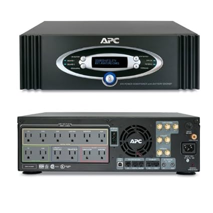

Not sure about these new models but on the APC S20BLK power conditioner that I have, when the unit kicks into battery back up an alarm mode is activated. It,s a timed interval beeping. Haven't looked into the ability to disabling it but it is not acceptable for continued musical enjoyment. But it does alert you to a power issue and gives you plenty of time to shut things down.
As Nikhil stated, I believe these units have primarily been designed for computer/server usage and not specifically designed for audio purposes.
However, for the most part they do a good job for us, just with a few quirks.
Not sure about these new models but on the APC S20BLK power conditioner that I have, when the unit kicks into battery back up an alarm mode is activated. It,s a timed interval beeping. Haven't looked into the ability to disabling it ...
The units can be programmed to stay silent. That's how I have mine set.
The default setting is set to beep.

The APC SMC1000-2U UPS has a Mute feature that allows the alarm beep to be silenced. When pressed, the lower left button mutes the alarm beep and the speaker symbol in the display changes to show a hash mark across the speaker.
